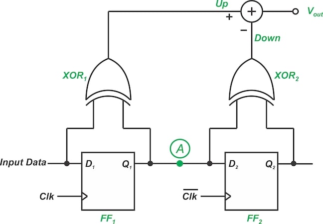

Shown in Figure 1 is the circuit schematic of the Hogge phase detector.
Schematic of the Hogge detector.
Figure 1. The Hogge phase detector.

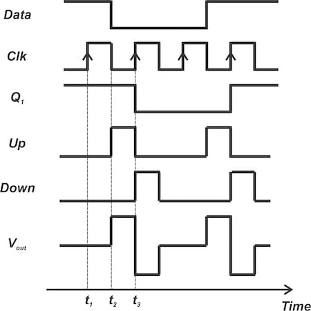

Data Transition Before the Sampling Clock Edge

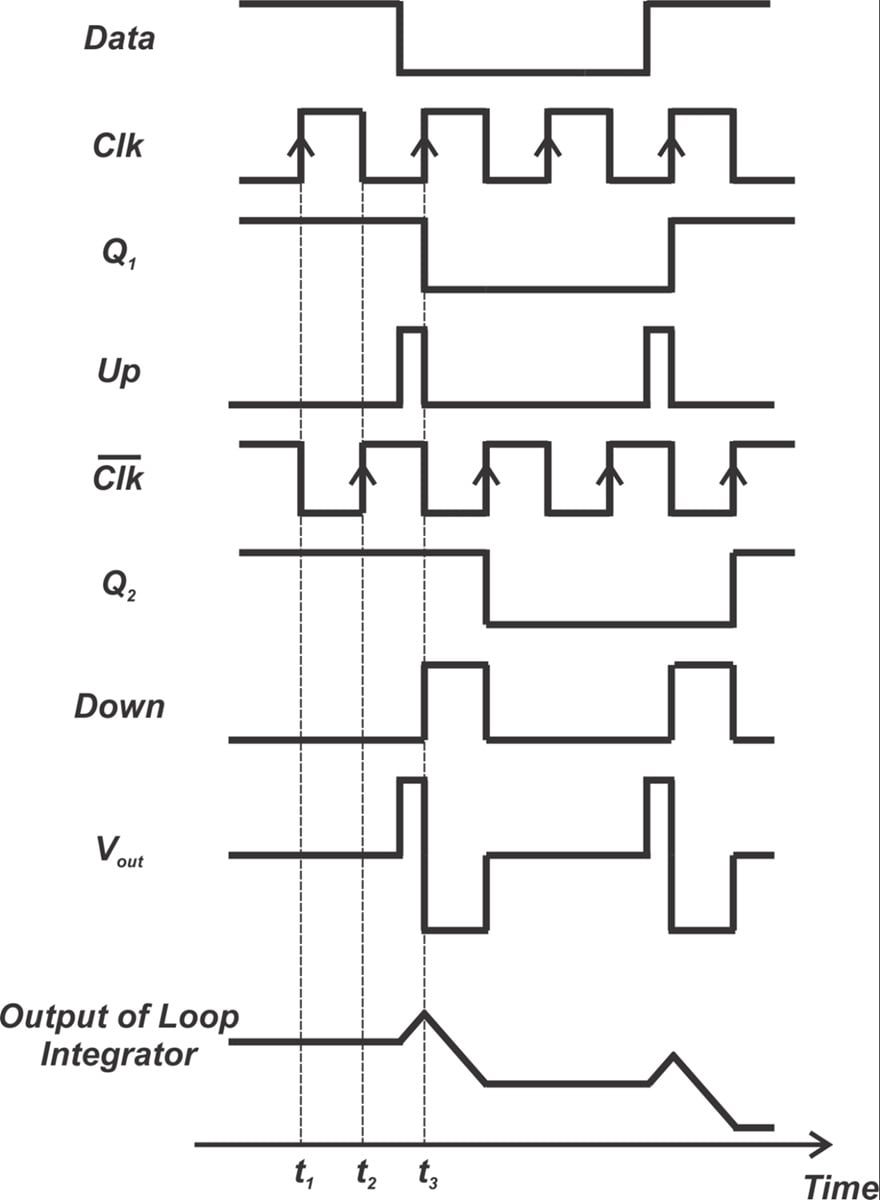

Figure 3 displays the waveforms for the first of the cases we'll examine. Here, the first data transition occurs slightly earlier than the clock rising edge at t = t3.
Hogge detector waveforms when the phase difference is π radians.
Figure 3. Hogge detector waveforms when the phase difference is π radians.
As we can see, the pulses at the Up output almost disappear.
This scenario corresponds to a phase difference of π radians. Given that, what is the average value of Vout?
Recall that the pulses generated at the Down output have a fixed width equal to half the clock period. Meanwhile, since the Up pulses are quite narrow, we can disregard them when calculating the average value. Ignoring the Up pulses, if the Down pulses occurred in every clock cycle we would see a square wave with a 50% duty cycle. This signal would switch between zero and –Vdd , with an average value of –Vdd/2.
It's important to note, however, that we have a Down pulse for each data transition instead of for every clock cycle. For instance, in the waveform above, two data transitions result in two pulses at the Down output. The timespan of the waveforms, on the other hand, covers four clock cycles.
The average output of this phase detector therefore depends on the data transition density. We can say that for maximum data transition density, the average output is –Vdd/2 when the phase difference is π radians.

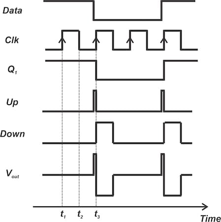

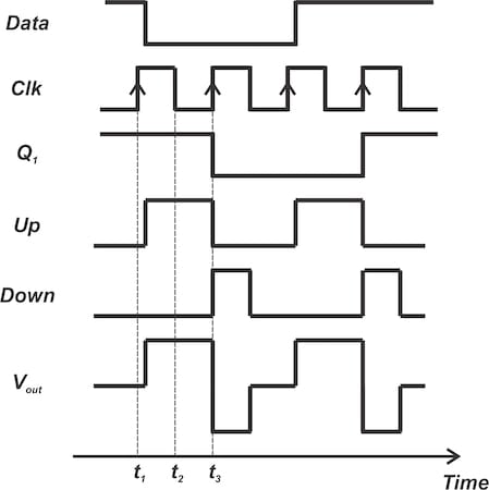

For our next scenario, let's say that the first data transition takes place just after t = t1. This is shown in Figure 4.
Hogge detector waveforms when the first data transition occurs just after the sampling clock edge.
Figure 4. Hogge detector waveforms when the first data transition occurs just after the sampling clock edge.
In this situation, the pulses at the Up output reach their maximum width, which is just under one clock period. Since the pulses generated at the Down output have a fixed width equal to half the clock period, the average of Vout is Vdd/2 for maximum data transition density.

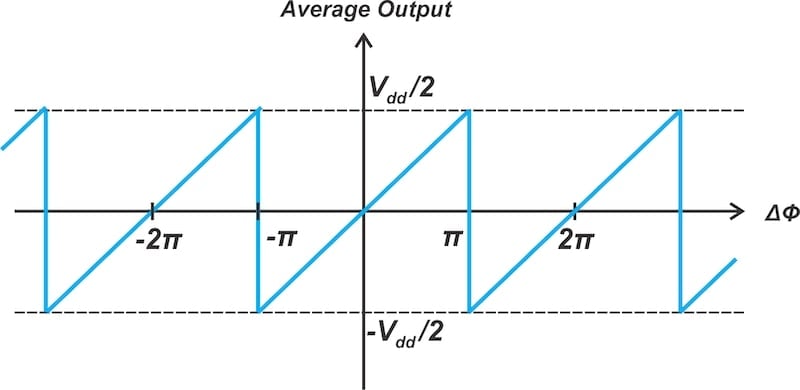

The above special cases should help you understand the input-output characteristic of the Hogge detector, which is depicted in Figure 6.
Input-output characteristic of the Hogge detector.
Figure 6. Input-output characteristic of the Hogge detector.
As we can see, the Hogge detector displays a linear sawtooth behavior.

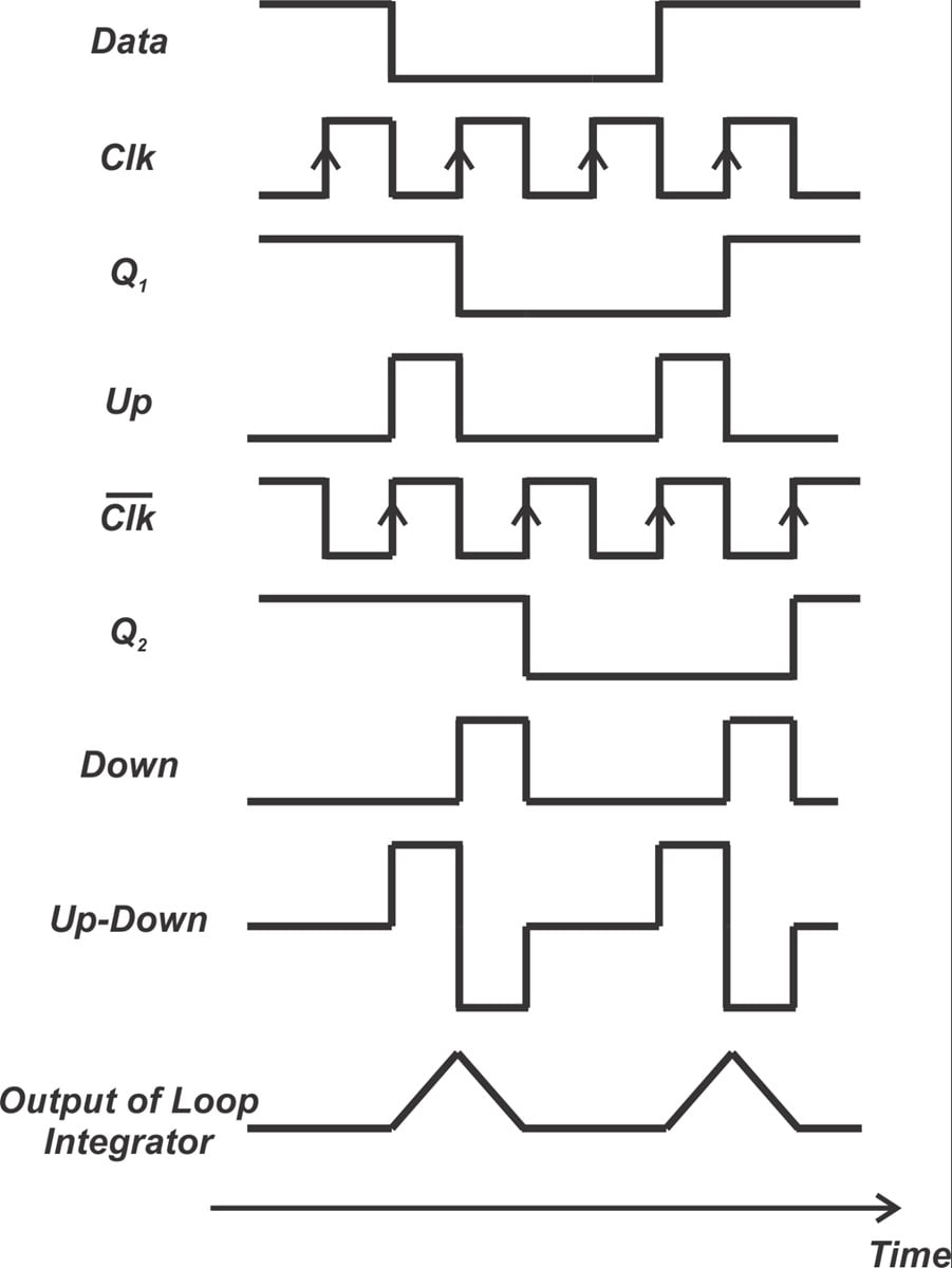

Although the Hogge phase detector exhibits a linear characteristic, it introduces noticeable ripple into the VCO control voltage. This is true even in the locked condition. To grasp this, let's take another look at the Hogge detector waveforms under this condition (Figure 7).
Operation of the Hogge detector in the locked condition.
Figure 7. [click to enlarge] The Hogge detector's operation in the locked condition.
As we can see, the Up and Down pulses are generated at separate times. This results in a triangular pulse at the output of the integrator. The pulse increases with a constant slope during the HIGH state of the Up pulse and decreases with the same slope when the Down pulse is HIGH.
This indicates that while the net change in the integrator output is zero, the detector temporarily adds a significant amount of charge to the loop filter and subsequently removes it, causing a ripple in the VCO control voltage. Since a triangular pulse is generated at each data transition, the ripples on the VCO control voltage are data-dependent. This ripple introduces data-dependent jitter into the recovered clock.

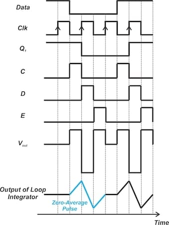

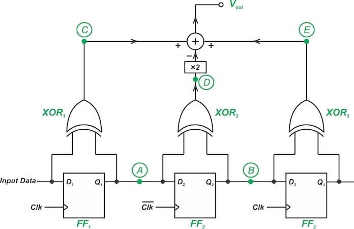

To mitigate this issue, the triwave phase detector substitutes the triangular pulses with pulses that have a zero average. Figure 8 shows the circuit schematic of the triwave detector.
Schematic of the triwave phase detector.
Figure 8. Triwave phase detector.
This phase detector incorporates a third stage composed of a flip-flop and an XOR gate. The second stage output is scaled by a factor of two.

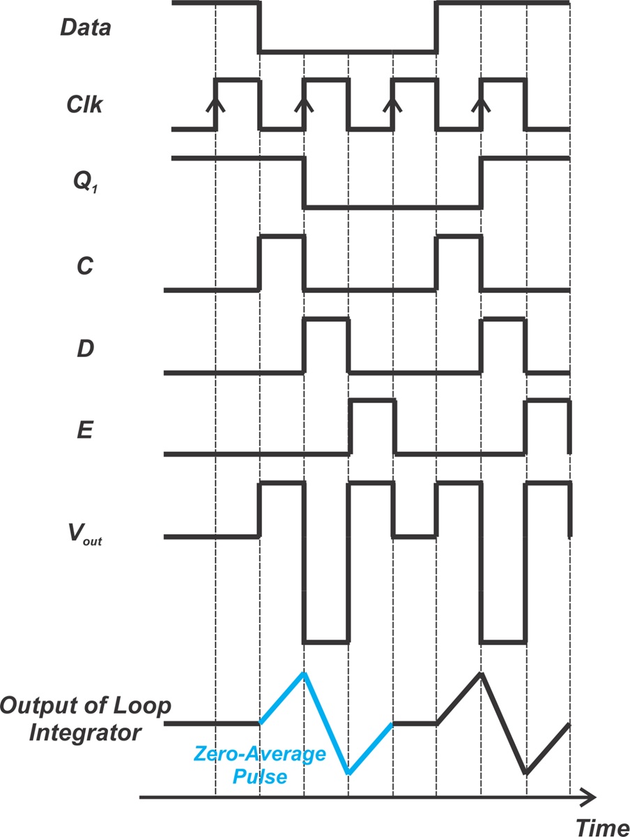

The circuit's waveforms in the locked condition are shown in Figure 9.
Waveforms of the triwave phase detector in the locked condition.
Figure 9. [click to enlarge] Waveforms of the triwave phase detector in the locked condition.
In this case, each data transition produces a ripple pulse consisting of three distinct sections. These ripple pulses exhibit a zero average due to their symmetry around the 0 V axis. As a result, the triwave phase detector significantly mitigates the data-dependent jitter characteristic of the Hogge detector.
