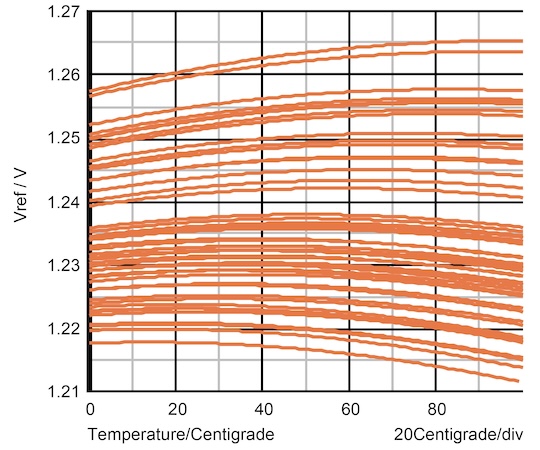

Dealing with Practical Limitations
When you plot Vref vs. temperature from a simulation, you get a false sense of precision. You will see the curve of Figure 9-6 only once in a while on a real IC, one that happens to have the exact nominal parameters.
Bandgap Reference Voltage Variation
What you have to live with is more like Figure 9-7, obtained from a Monte Carlo run.
Variation of bandgap reference voltage using a Monte Carlo simulation
Figure 9-7. Monte Carlo analysis reveals the larger bandgap voltage variation that you will see in production.
Figure 9-7 shows a variation of about ± 2.5% over a range of 0 to 100 °C. This can be reduced by trimming. The best component to trim is R2. As you can see, there’s a distinct relationship between voltage and temperature coefficient, and R2 controls both.
Even with trimming, there’s a limit to accuracy. When a chip is attached to a lead-frame in a package, there is always some stress. The stress changes the bandgap potential. Unless some unusual precautions are taken, Vref can change as much as 0.5% (in either direction) compared to the value measured (or trimmed to) on the wafer. This can be avoided if the reference supports trimming in the package, of course.

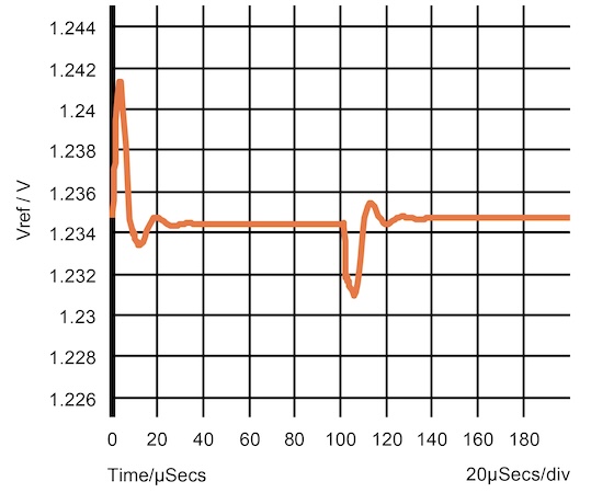

Bandgap Reference Frequency Stability
The use of a PNP transistor at the output makes frequency compensation of a feedback loop difficult. This is especially true for a slow lateral PNP transistor.
About the only practical way to compensate this circuit is to place a large (external) at the output. Even so, a small resistor in series with the capacitor is required to create a zero (see the previous discussion of Frequency Compensation of Amplifier Circuits).
As illustrated by the transient pulse response in Figure 9-8, the loop is stable.
Pulse response of a bandgap reference voltage
Figure 9-8. Pulse response of a Brokaw cell bandgap reference, indicating stability.

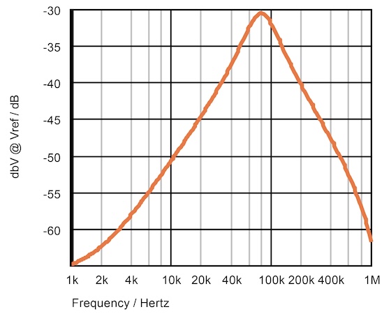

Power Supply Rejection
Another key consideration is the stability of the bandgap reference voltage —as illustrated in Figure 9-9, the power supply rejection of the Brokaw cell design at 100 kHz is a mere –30 dB.
Power supply rejection over frequency for a Brokaw cell bandgap reference
Figure 9-9. Power supply rejection for a Brokaw cell bandgap reference.
