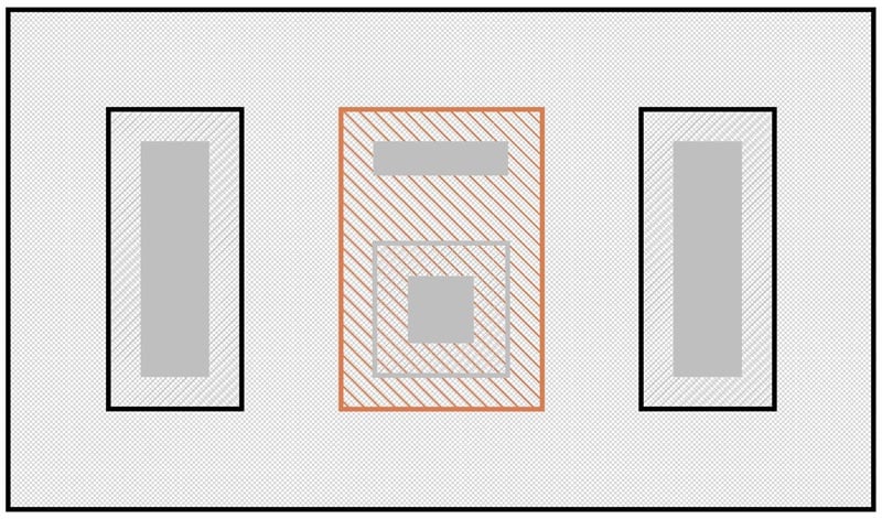

Figure 19-15 shows one way of creating a cross-under. The N+ rectangle is placed inside a base diffusion, which itself sits inside an epi-island. One side of the cross-under is connected to the base region. It doesn't matter which side, since the voltage drop across the cross-under is bound to be much smaller than that of a diode.
N+ cross-under.
Figure 19-15. N+ cross-under.
If the epi-island is biased at the highest positive supply voltage, you can have several such cross-unders in the same island.
The epitaxial region can serve as a cross-under as well, though it takes up more space.

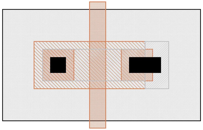

The NPN transistor with two collector contacts (Figure 19-16) is a special case of using the diffused layer for routing. Here, a line connected to the collector stops at the right-hand contact and continues on at the left-hand one.
Two collector contacts in an NPN transistor can act as a cross-under.
Figure 19-16. Two collector contacts in an NPN transistor can act as a cross-under.
Be careful with this scheme, however. Let's assume the resistance between the contacts is 100 Ω. The resistance between one contact and the center point underneath the emitter is then about 50 Ω. If one contact carries all or most of the collector current, the second contact will reflect the voltage at the center and not that of the first contact.

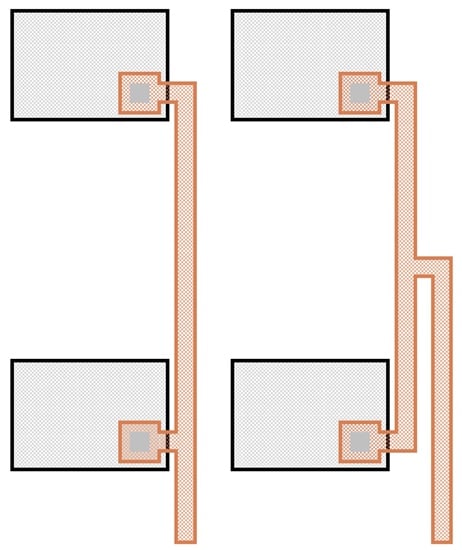

Similarly, on the IC, use separate metal runs to connect sensitive devices. Figure 19-18 shows the right and wrong way to do this.
Proper connection (on the right) and improper connection (on the left) for matching devices.
Figure 19-18. Proper connection (on the right) and improper connection (on the left) for matching devices.
In this figure, the left-hand connection can create an error. For example, say that the runs lead to emitters carrying 1 mA. With 50 squares (at 30 mΩ/□) of additional aluminum for the upper device, the voltage drop is 1.5 mV. This creates a current mismatch of 6% at room temperature. The balanced connection on the right avoids this problem.
