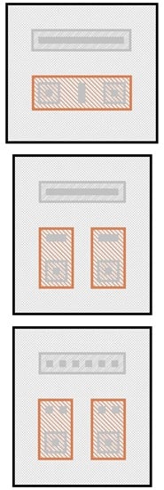

Figure 19-4 shows NPN transistors with two emitters in a single island (or tub).
Two-emitter NPN transistors.
Figure 19-4. Two-emitter NPN transistors.
In the top pattern collector and base are common, meaning that they are connected together. This limits the usefulness of the device.
In the center pattern there are separate bases—only the collector is common. The bottom pattern is identical, with the contacts redrawn for uniform size.
There is a danger to having multiple emitters in the same island. As mentioned before, the image of the buried layer is shifted (at least, in all but low-pressure epitaxial processes). The actual buried layer region is a rectangle covering the area from the collector contact (and sinker) to the far edges of the base regions. But the image appearing on the surface is shifted along the crystal axis.

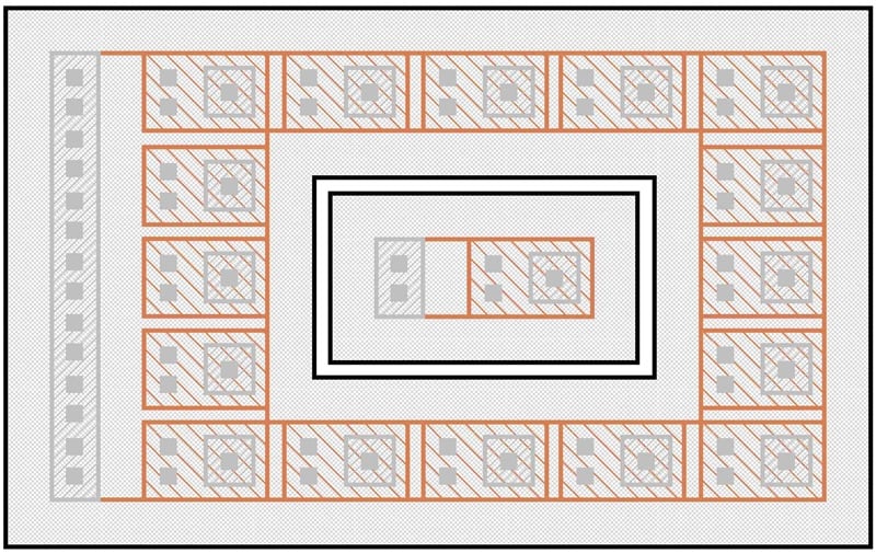

This effect can be avoided if the entire transistor is rotated so that the edge of the shifted pattern falls between the collector contact and the bases. Figure 19-6 shows this with a two-transistor layout. The center transistor has a single emitter, while the outer one has 16. This layout is used, for example, in a bandgap reference.
16:1 emitter ratio with epi-shift mismatch avoided.
Figure 19-6. 16:1 emitter ratio with epi-shift mismatch avoided.

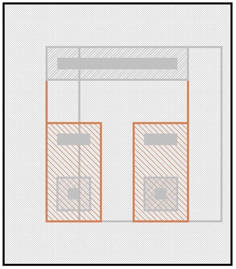

The transistor patterns shown so far are all intended to be the smallest possible size, which naturally limits how much current they can carry. To increase the current capability, the effective emitter length needs to be increased. For the NPN transistor in Figure 19-7, not only have the emitters been tripled and stretched, but base contacts have been placed on both long sides.
NPN transistor for higher current.
Figure 19-7. NPN transistor for higher current.
Note that the increase in current capability almost always requires wider metal runs for both the emitter and collector.
