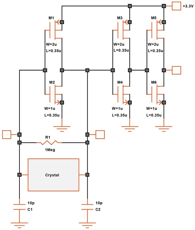

Let's start our discussion of crystal oscillators with the commonly-used CMOS circuit illustrated in Figure 13-23.
CMOS crystal oscillator.
Figure 13-23. CMOS crystal oscillator. [click to enlarge]
The crystal is connected between the input and the output of an inverter. Since an inverter is ill-equipped to remain in a state between low and high, R1 is employed to force it—at least initially—into the linear region.
C1 and C2 are a mystery to most designers. They’re there because the crystal manufacturer specifies them.

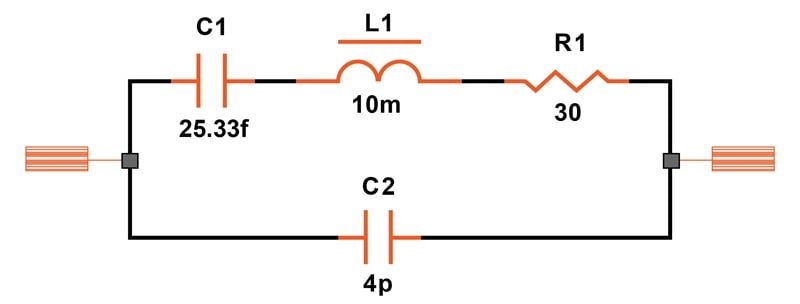

Quartz is piezoelectric: a voltage applied across the quartz surfaces makes it flex, which creates a voltage between its surfaces. For circuit timing applications, a crystal is simply a sliver of quartz that vibrates.
The vibrating mass of the crystal can be represented as a series-resonant LC circuit (C1, L1) with a series resistance of R1. This is illustrated in Figure 13-24. C2 is the stray capacitance created by the contacts to the crystal and the wires and pins of the package.
Model of a crystal.
Figure 13-24. Model of a crystal.
The quality factor (Q) of such an LC circuit is given by:
$$Q ~=~ \frac {2 \pi f L_1}{R_1}$$
and its resonant frequency (f) by:
$$f ~=~ \frac {1}{2 \pi \sqrt {L_1C_1}}$$
Note that the values in Figure 13-24 were chosen to give a series-resonant frequency of exactly 10 MHz and a Q-factor of 20,000. Crystals have Q-factors in the range of 10,000 to 2 million—far higher than those of LC circuits. Ceramic resonators, which are otherwise almost identical to crystals, also have considerably lower Q-factors.

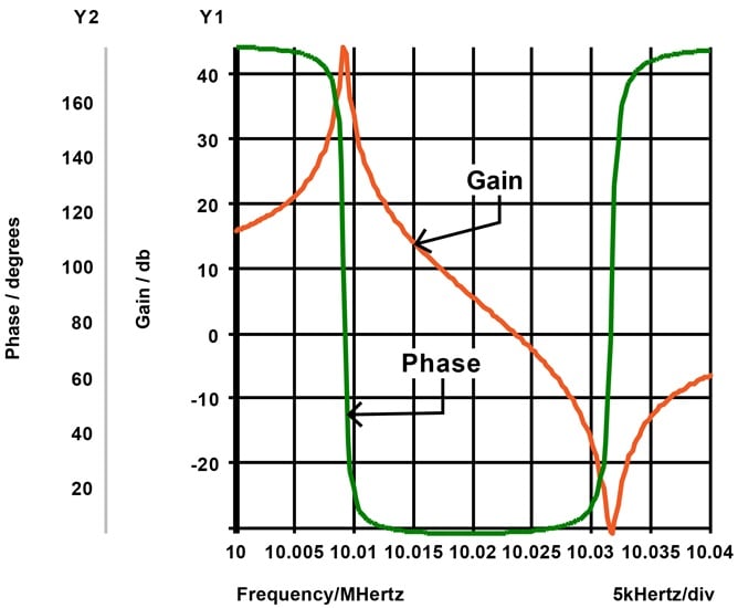

If we open the feedback loop in Figure 13-23, we can see what’s happening: there are, in fact, two resonances, about 0.2% apart from one another. The lower one is the series resonance; the higher one is the parallel resonance. As Figure 13-25 shows, the phase shifts abruptly between 180 and 0 degrees at these two frequencies.

However, even the series resonance is influenced by the additional capacitances. As you might notice from the plot of Figure 13-25, the series resonance frequency is not exactly 10 MHz. There are two reasons for this:
  1. At resonance the phase moves from 180 degrees to zero, but it doesn't actually reach zero (the condition required for oscillation) until about 10.015 MHz.
  2. At resonance, the impedance of a series resonant LC circuit becomes very low, limited only by R1. It therefore works best if the input impedance of the inverter is low.
In Figure 13-23, all we have for input impedance is a 10 pF capacitance plus the gate capacitances. Thus, C1 of the crystal sees itself in series with this 10 pF capacitance, making the effective capacitance slightly smaller.

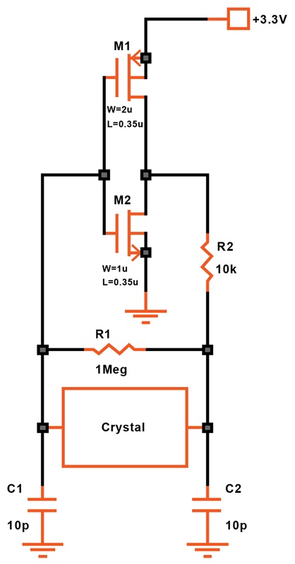

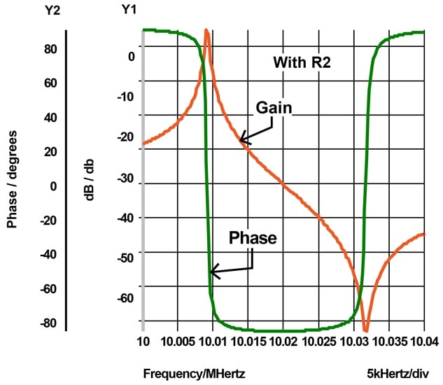

In the circuit of Figure 13-26, we shift the phase in the feedback loop with an additional resistor (R2) working against C2. Now, we reach a zero degree phase-shift at the series-resonant frequency. This is illustrated in Figure 13-27.
The insertion of R2 in Figure 13-26 brings the phase shift to zero degrees at the series resonance.
Figure 13-27. The insertion of R2 in Figure 13-26 brings the phase shift to zero degrees at the series resonance.
With R2, the frequency is more accurate. The chances of the crystal operating at some unwanted frequency (including harmonics) are diminished. However, be aware that R2 decreases the loop gain—make sure it safely exceeds unity.

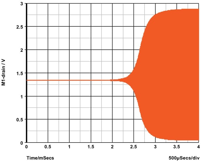

Simulating a crystal oscillator can be a frustrating task. The higher the Q-factor, the longer it takes for the oscillation to build up. For the circuit of Figure 13-26, it takes 3 ms for the oscillation to reach full amplitude as shown in Figure 13-28. That means you have to wait for 30,000 cycles before you can see the actual waveform.
Start-up of a crystal oscillator.
Figure 13-28. Start-up of a crystal oscillator.
If you want to measure the frequency accurately, you need to simulate using very fine time steps (say, 1 ns). Therefore, our 3 ms simulation will require 3 million time steps.
