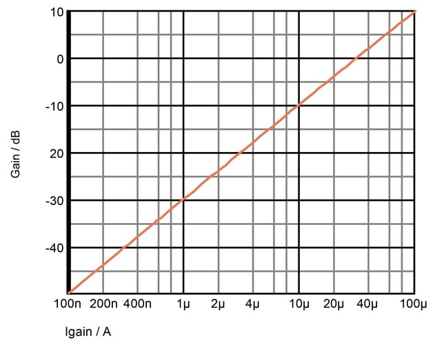

Gain Control
The one great feature of a circuit like this is the precise control of gain over a wide range. Figure 12-3 shows the gain (in dB) vs. Igain.
Gain is a precise logarithmic function of hte operating current.
Figure 12-3. Gain is a precise logarithmic function of Igain.
A linear change in current results in a logarithmic change in gain. Thus, for audio applications, you can control the volume (a logarithmic function) with a linear current or voltage. The accuracy is within ± 0.2 dB. True to the exponential nature of the base-emitter diode, the gain changes 20 dB per decade of current.
Because the diode-connected transistors (Q16 and Q17) track the input transistors, gain is virtually unaffected by temperature. If Igain is derived from a resistor made from the same layer as R1, R2, and Rload, the gain is also unaffected by absolute variations. Figure 12-4 shows the output’s waveforms as a function of gain current for a 1 kHz sinusoidal input.
