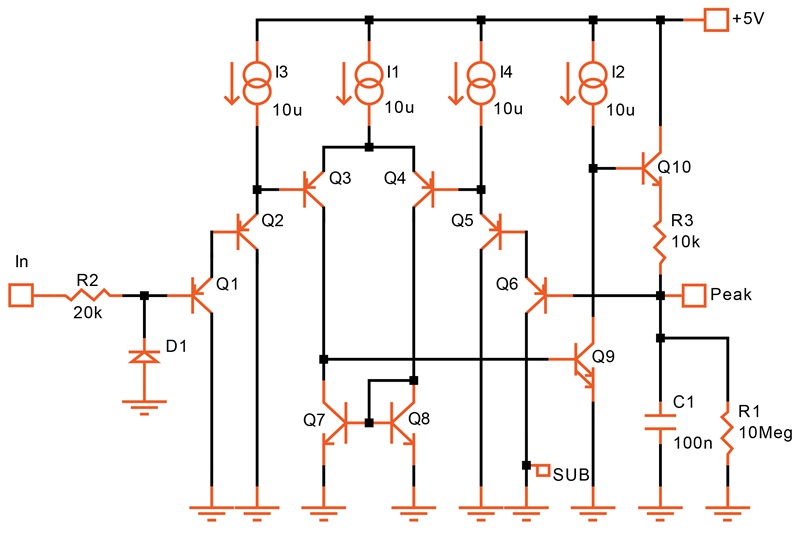

When you analyze the feedback loop in Figure 18-10, you find that the diode and the capacitor at the output place an unusual burden on the op amp. When the signal moves up (for a positive peak detector) the output is connected to a large capacitance. When the signal moves down, there is no load at all.
Peak detector with differential NPN Darlington pair.
Figure 18-10. [click to enlarge] Peak detector with differential NPN Darlington pair.
This circuit uses a bipolar Darlington pair to provide a high-impedance input at the (external) capacitor. For operation over a wide temperature range, the outer transistors (Q1, Q4) are biased at about 0.8 μA by Q9 and Q11. The output impedance of the op amp is artificially enlarged by R3 to provide frequency compensation (together with C1).
A Fundamental Question
There is a fundamental question to every peak detector: How long should the voltage stay on the capacitor? If the answer is "forever," then the detector displays the highest peak for an infinite history of input signals. This is probably not what you want.
For any other answer, you have two choices:
  1. Discharge C1 slowly, so the voltage stays within the desired accuracy over the time of interest.
  2. Reset C1 before each measurement.
In the circuit of Figure 18-10, the capacitor is discharged by the base current of Q4. This current amounts to about 5 nA. If the peak voltage is 1 V, you lose about 1% in 200 ms with 100 nF of capacitance. The discharge current varies from chip to chip and with temperature.

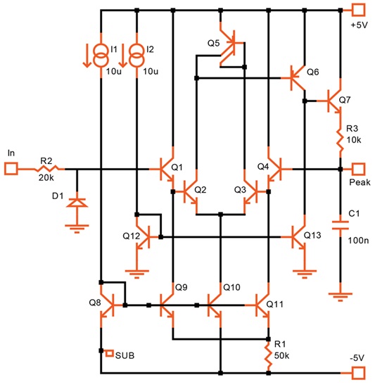

Figure 18-11 shows a peak detector that operates from a single supply voltage.
Single-supply peak detector with a lower input current.
Figure 18-11. Single-supply peak detector with a lower input current.
The Darlington input pair of the op amp is more elaborate, and the operating currents of the outer transistors (Q1, Q6) are merely the base currents of the inner ones. This limits the temperature range to about 100 °C, but it also lowers the input current.
Notice the discharge resistor R1. Without it, the base current of Q6 would charge C1 (it flows out of the base). Thus, in this circuit, a controlled rate of discharge through R1 is essential.
In both examples, the supply voltage must be lower than the emitter-base breakdown voltage of the output transistor. If it needs to be higher, use an additional diode in series with the emitter.
