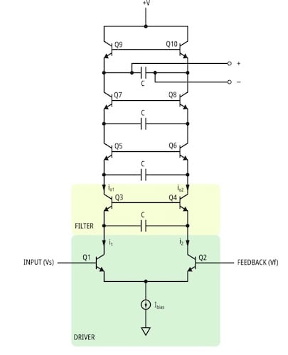

The Moog filter has a differential input. We can view the input terminals as currents (base currents) flowing into the transistors or as voltages either relative to ground, or as base-emitter voltages. The output voltage is taken from the final filter stage’s capacitor, with the left side being positive as shown and the right side being negative. The circuit we've constructed so far is shown in Figure 2.
Figure 2. The Moog filter, with the driver section and one of the filter sections labeled.
The output of this filter, with four filter stages, is given by:

Figure 5. The full Moog ladder filter with feedback and component values the same as in the Moog Prodigy.
