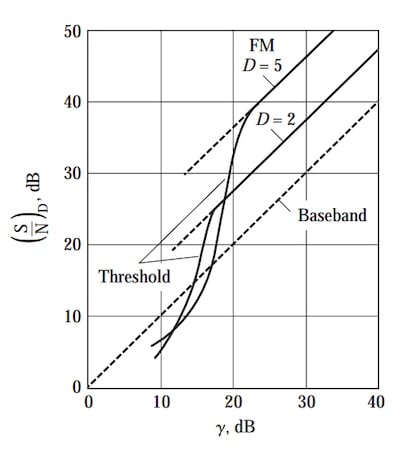

Figure 1 presents the output SNR versus baseband SNR γ for an FM waveform with single-tone modulation. Curves are provided for deviation ratios D = 2 and 5.
Figure 1. The output SNR versus baseband SNR for an FM signal
modulated by a sinusoidal tone. Image used courtesy of A.
Figure 1. The output SNR versus baseband SNR for an FM signal modulated by a sinusoidal tone. Image used courtesy of A. Bruce Carlson

Figure 1 shows that once the threshold is exceeded, FM systems achieve significant noise reduction. A higher deviation ratio D leads to a higher output SNR. This highlights the classic trade-off in FM between spectral efficiency and noise immunity, as increasing D inevitably demands greater bandwidth.
However, this trend doesn’t necessarily hold below the threshold. For example, at a baseband SNR of approximately 15 dB, increasing the deviation ratio from D = 2 to D = 5 results in a lower output SNR. This indicates that bandwidth cannot be exchanged indefinitely for SNR. An excessive deviation ratio may even degrade system performance.

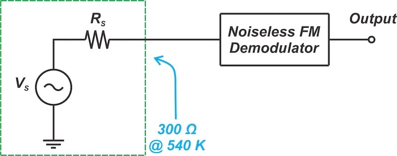

Figure 2 depicts the test setup’s block diagram, detailing the noisy demodulator and signal generator.
Figure 2. Block diagram of the test setup.
Figure 2. Block diagram of the FM signal generator test setup.

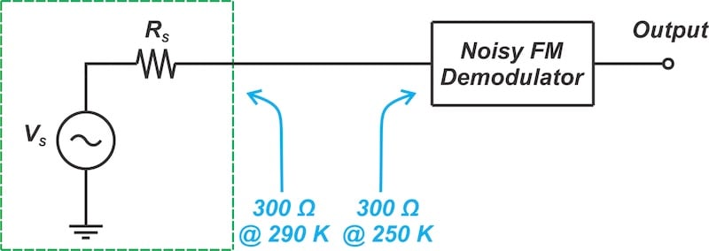

We can assume that the demodulator is noiseless and instead increase the initial temperature of Rs by TM = 250 K to account for the demodulator’s noise. This is illustrated below.
Figure 3. The equivalent model of the test setup used for noise
calculations.
Figure 3. The equivalent model of the FM signal generator test setup used for noise calculations.
The available noise power of a resistor—that is, the noise power it can deliver to a matched resistor—is independent of its resistance value. The noise power is given by kTB, where:
k is Boltzmann’s constant (1.38 × 10⁻²³ joules per kelvin)
T is the temperature in kelvin
B is the bandwidth in hertz.
Therefore, the available noise power at the input of the demodulator is:
$$P_n = k TB = (1.38 \times 10^{-23}) \times (290+250) \times 200 \times 10^3 = 1.49 \times 10^{-15} \ W$$
Equation 18
Assuming a threshold CNR of 10, the minimum signal power is Ps = 1.49×10-14 W or -108.3 dBm. Since this power is delivered to a load resistance of 300 Ω, the carrier amplitude should be:
$$P_s = \frac{A_c^2}{2R} \Rightarrow A_c = \sqrt{1.49 \times 10^{-14} \times 2 \times 300} \approx 3 \ \mu V$$
Equation 19
