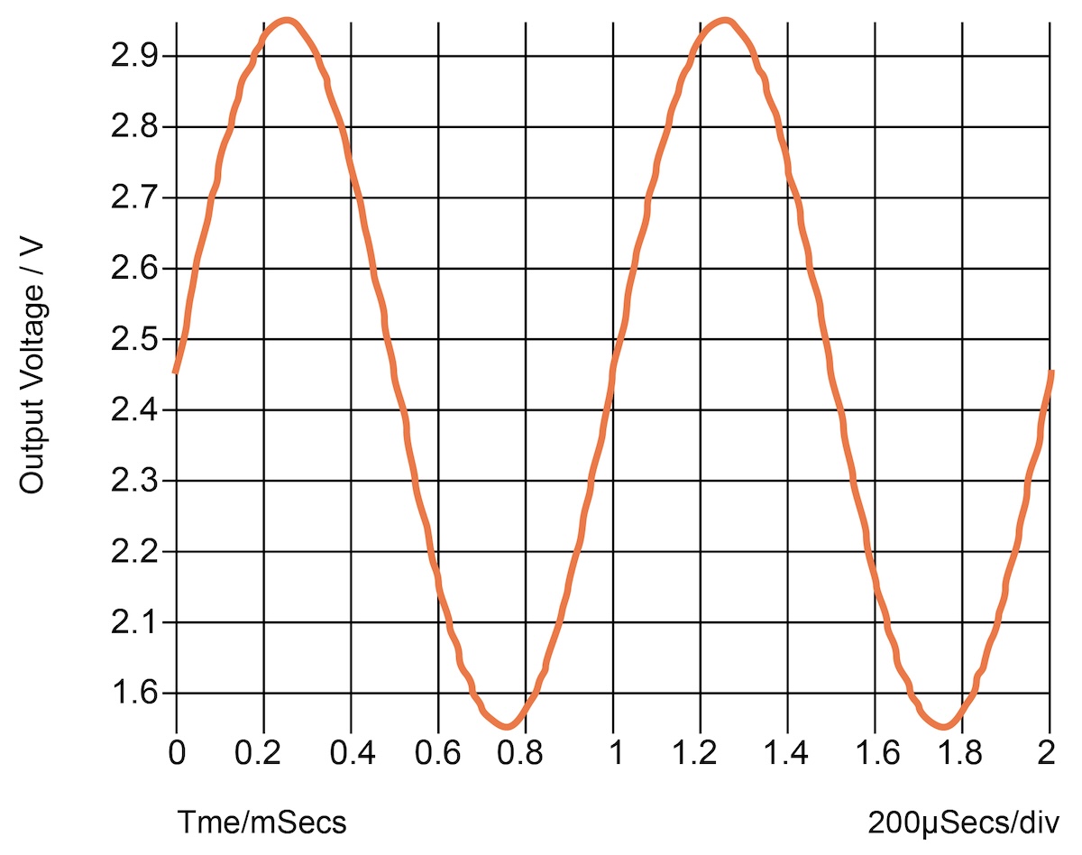

Figure 3-8 shows a transient analysis where the 1 V input has been changed to a sine wave at 1 kHz.
Output voltage transient response from bipolar buffer with 1V sinusoidal input
Figure 3-8. Transient analysis 2: output voltage from a 1 Vpp sine-wave at the input. [click to enlarge]
Changing the input to a sine wave will help you learn a great deal more about the circuit. It will be immediately obvious if the circuit can reproduce the waveform without clipping it at either the high or low excursions. That’s only a rough impression of fidelity, however. What you need to know is the amount of distortion in the waveform.

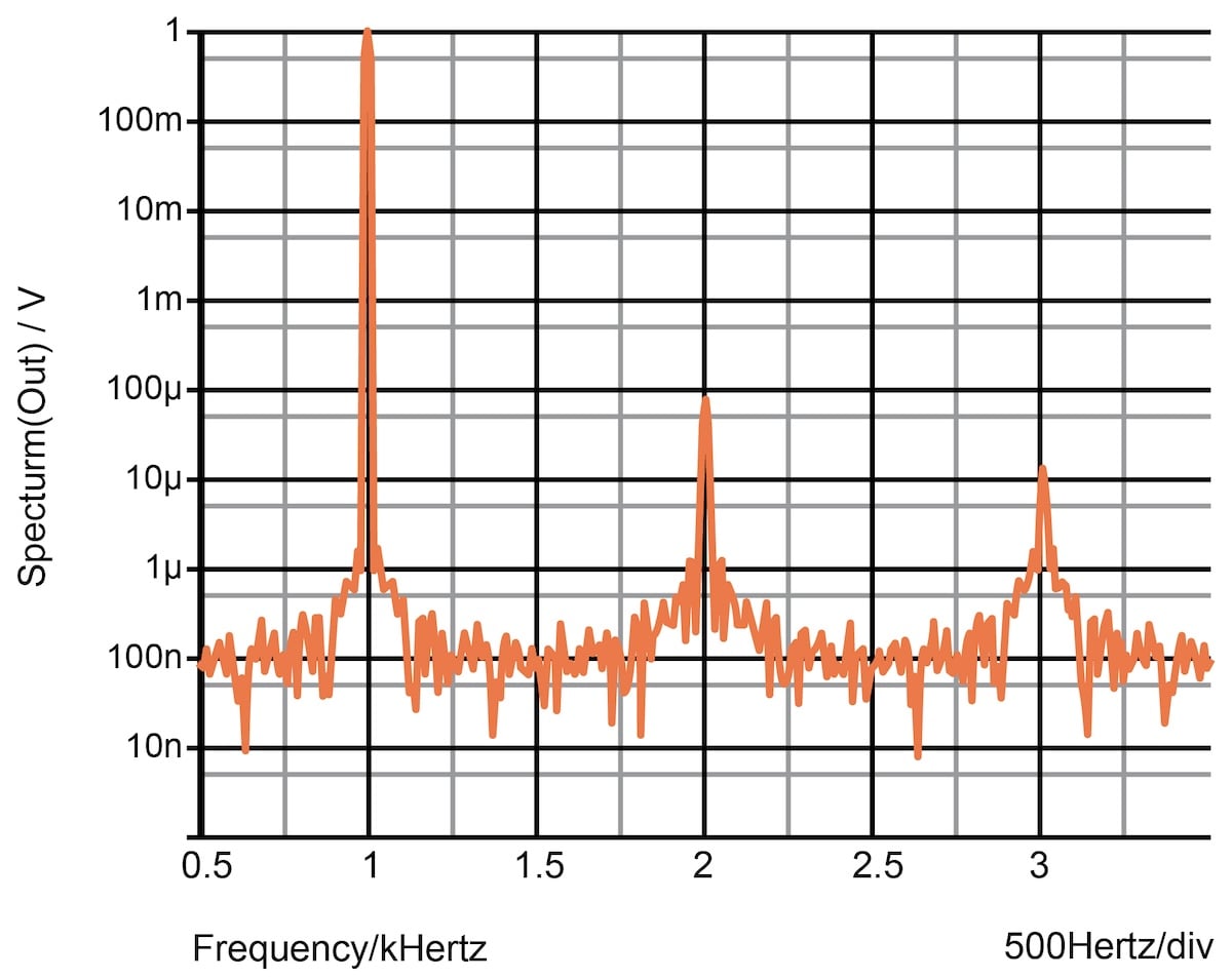

In some programs, you simply display the sine wave, click on the distortion button, and get the result. But if you want to have all the information, nothing beats a Fourier Analysis.
Fourier Analysis
The Fast Fourier Transform (FFT) is a routine that extracts the frequency components from a waveform. It’s rather tricky to use and sometimes produces errors.
Figure 3-9 shows the result of a continuous Fourier analysis, which is both more detailed and more reliable than the FFT.
Frequency response from bipolar buffer with 1V sinusoidal input
Figure 3-9. Continuous Fourier analysis frequency spectrum. [click to enlarge]
What we see in the graph is amplitude versus frequency. At 1 kHz is the fundamental frequency, which has an amplitude of nearly (but not quite) 1 V. At 2 kHz is the second harmonic, with an amplitude of 100 µV, or 0.01%. The third harmonic measures about 12 µV, or 0.0012%.
To get this kind of resolution, you need to run the sine wave for many cycles (at least 1,000) with small enough timesteps.
