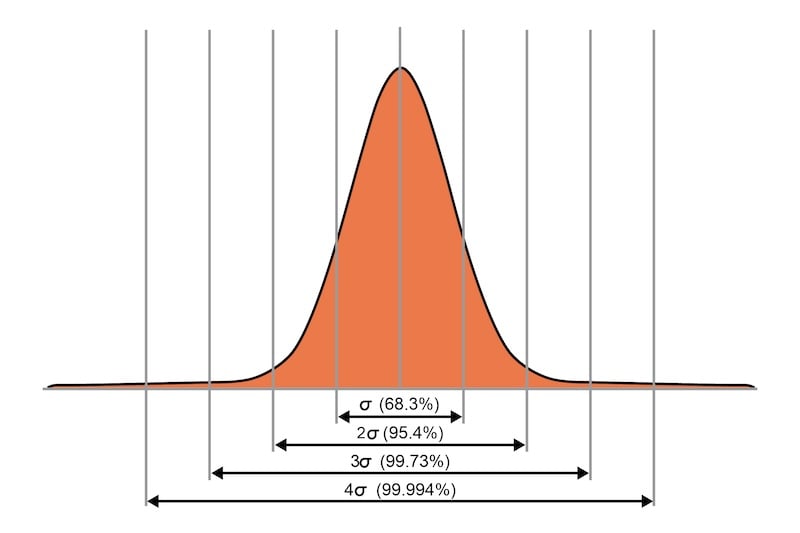

Most parameters follow a "normal," or Gaussian, distribution. This distribution is illustrated in Figure 3-10.
The normal, or Gaussian, distribution
Figure 3-10. The normal, or Gaussian, distribution.
In a normal distribution, the number of occurrences is maximum at the mean value. A deviation of ±σ (sigma) from this point contains 68.3% of all measured values. If you allow the deviation to be three times as large (±3σ), you enclose 99.73% of all measurements.
This sounds like you’re discarding only 0.27% of all values, but the figure is deceiving—we’ve considered only one parameter, when there are many in an integrated circuit. Suppose your design is influenced by 50 parameters: the total parameter "yield" is then .997350, or 87.4%. This means you would discard 12.6% of all chips on a wafer.
Unless you simply don't care about cost, you need to design an analog IC so no chips are lost because of parameter variations. In other words, the design needs to withstand a variation of each and every device parameter to at least 3σ. Even then, 4σ would be better.

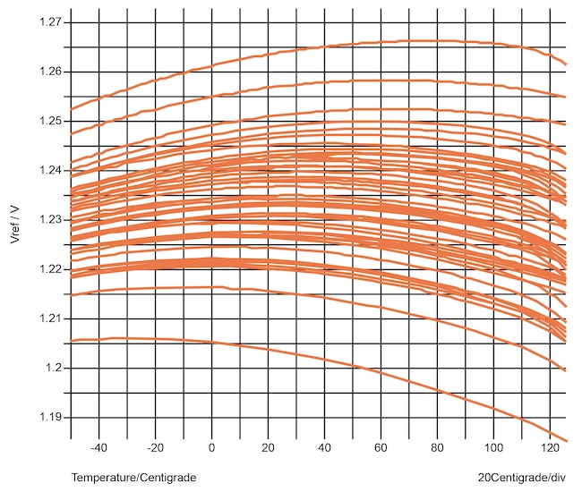

These "tolerances" are either inserted into the model file directly or contained in a separate file, depending on the analysis program used. The Monte Carlo program then simply runs the chosen analysis repeatedly, each time with a different set of variations, randomly chosen. For example, Figure 3-11 shows the variation over temperature for an untrimmed bandgap reference.
Monte Carlo analysis of an untrimmed bandgap reference over temperature
Figure 3-11. Monte Carlo analysis of an untrimmed bandgap reference over temperature.
How many runs need to be specified for a Monte Carlo analysis? There’s an easy way to find out: start with 20, then increase this number until the extremes no longer change. For this analysis, 50 runs were used, which is more than we needed. With today's fast computers, you can afford to go overboard, though—the analysis took all of 8 seconds!
This one picture gives you the variation of a reference voltage over temperature exactly as it will happen in production. Notice that there’s a Gaussian distribution (more curves at the center, fewer at the extremes). Between the top and bottom curves lie 99.73% (3σ) of all circuits.
