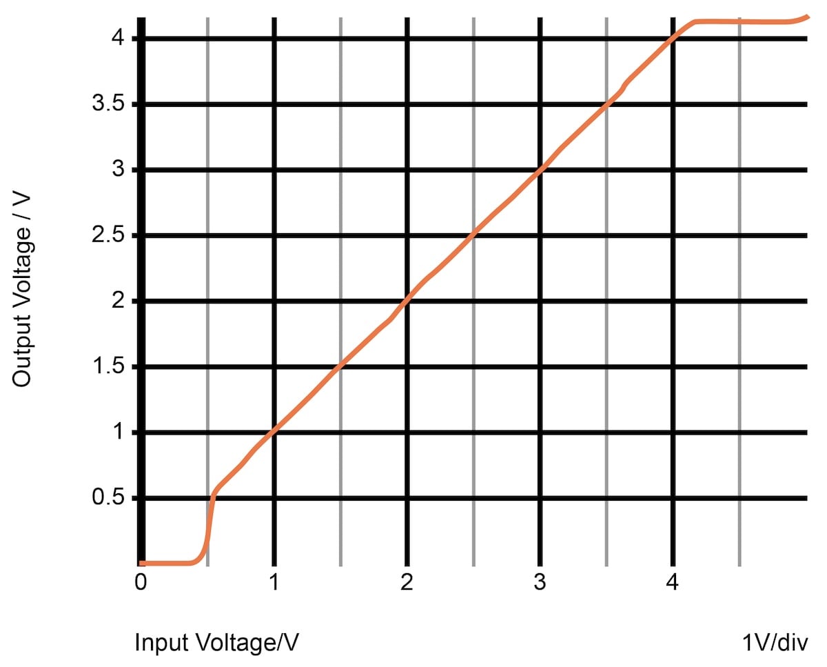

In the most basic DC analysis, we continuously change (sweep) Vin from 0 to 5 V and observe the output (Figure 3-2). The simulator tells us that the output follows the input, but only within the common-mode range: above about 0.6 V and below 4.1 V.
A DC analysis, showing the common-mode range
Figure 3-2. DC analysis of the bipolar buffer circuit showing the common-mode range. [click to enlarge]
