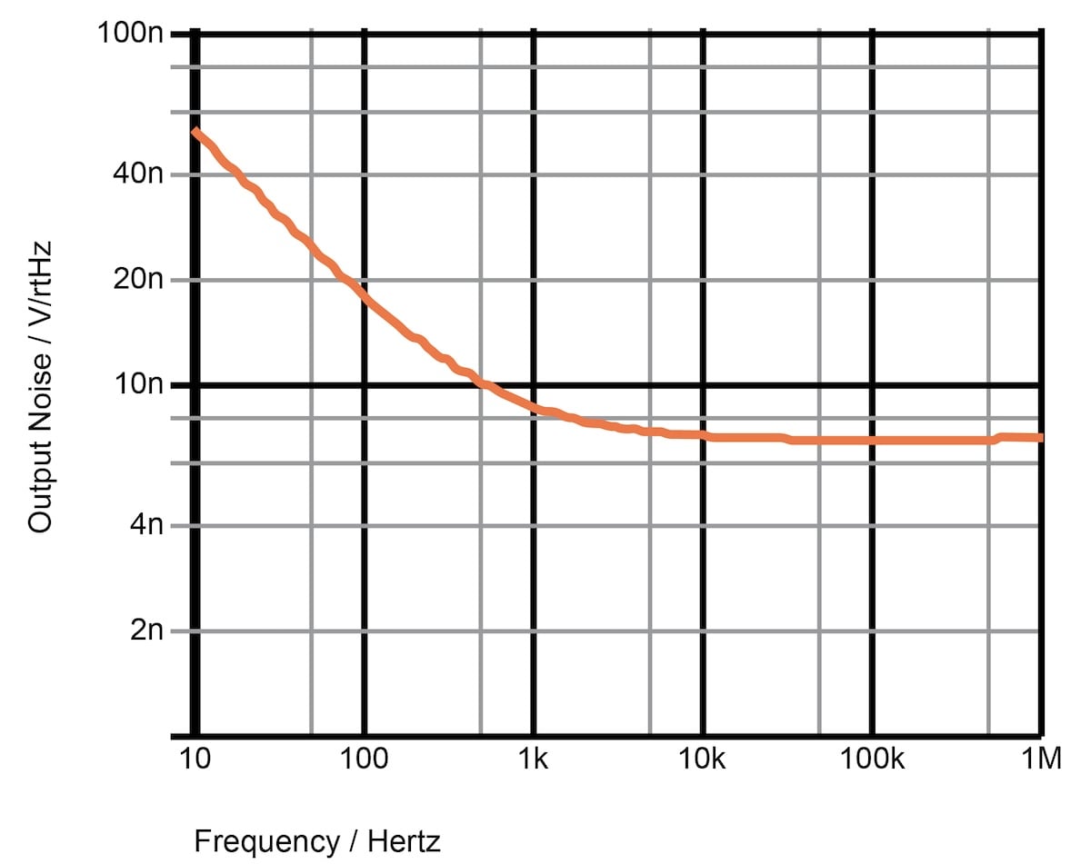

Noise Analysis
SPICE also supports the simulation of circuit noise. It is similar to AC analysis. Here, the AC source is turned off, and the combined effect of all noise sources inside the circuit (resistors, currents) at the output is displayed. Figure 3-4 shows an example of the output noise vs. the frequency.
Output vs. frequency response for the bipolar buffer from SPICE noise simulation
Figure 3-5. Output noise vs. frequency. [click to enlarge]
The measure is nV/√Hz or μV/√Hz. Despite the awkward name, it’s, in fact, an elegant measure. To get the actual noise (usually in μVrms), you simply multiply the value taken from the curve by the square root of the frequency interval of interest.
For example, between 100 Hz and 1 kHz, we read an average of about 12 nV/√Hz. Multiply this by the square root of 900, and you get 360 nVrms of noise. This is the noise value if you use a bandpass filter that cuts out everything below 100 Hz and above 1 kHz.
Similarly, we would measure about 24 nVrms in the flat (white noise) region between 10 kHz and 1 MHz. Even though the curve has a lower value, the total noise is much larger because of the wider frequency range.
