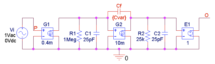

Let us use our running PSpice circuit example, first introduced in my article on op-amp frequency compensation, to compare decompensation versus full compensation:
Figure 1. PSpice circuit to plot a fully compensated and a decompensated open-loop gain.

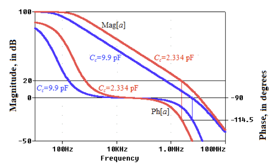

The results from PSpice can be seen in the figure below:
Figure 2.  Open-loop gains with full compensation (Cƒ = 9.90 pF for closed-loop gains ≥ 0 dB) and with decompensation (Cƒ = 2.334 pF for closed-loop gains ≥ 20 dB).  Both compensations enjoy ɸm ≥ 65.5°
The results elicit the following observations:
  • With full compensation (Cƒ = 9.90 pF), the 0-dB gain has the crossover frequency ƒx ≈ 5.86 MHz and the phase margin ɸm = 65.5°. Also, if we configure the fully-compensated op-amp for a 20-dB closed-loop gain, it has ƒx ≈ 633 kHz and ɸm ≈ 87°, an even greater margin than the 0-dB gain.
  • With decompensation (Cƒ = 2.334 pF), the 20-dB gain has ƒx ≈ 2.37 MHz (a wider bandwidth than with full compensation) and still ɸm = 65.5°. However, were we to configure the decompensated op-amp for a 0-dB closed-loop gain, it would have ƒx ≈ 11.1 MHz and ɸm ≈ 24°, a poor margin because the decompensated device is meant for gains ≥ 20 dB.  With ɸm ≈ 24°, the 20-dB gain would exhibit a peaking of about 7% and a transient response with an overshoot of about 50%, both of which are usually unacceptable.

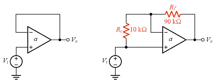

To illustrate, let us take the op-amp of Figure 1 in a decompensated form with Cƒ = 2.334 pF, and let us configure it for voltage-follower operation as in Figure 3(a).
(a)                                                                                                              (b)
Figure 3. Voltage follower: (a) Uncompensated, and (b) compensated externally for ɸm ≈ 65.5°.
As mentioned, this circuit has a phase margin of only ɸm ≈ 24°. How do we raise it to ɸm = 65.5°?  A simple solution is to raise its 1/β curve to 20 dB, while still ensuring unity gain. We achieve this by connecting a resistance pair Rc-Rƒ in a 1-to-9 ratio as shown in Figure 3(b). The closed-loop gain in the idealized limit a → ∞ is still
$$A_{ideal}=1.0V/V$$
Equation 1
(This is the case because for a → ∞ the voltage across the op-amp’s input terminals tends to zero. This implies zero current through Rc and, thus, zero current also through Rƒ. Consequently, the voltage across Rƒ is zero, so we have Vo = Vi.)
However, the feedback factor β, which we find via the test circuit of Figure 4(a) is
$$β=\frac{V_{n}}{V_{t}}=\frac{R_{c}}{R_{c}+R_{f}}=0.1$$
Equation 2
or 1/β = 10 = 20 dB (note that 1/β ≠ Aideal in this example).

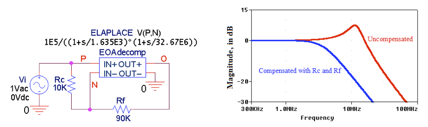

The responses are shown in Figure 5.
(a)                                                                                                                                                 (b)
Figure 5. (a) PSpice circuit to visualize (b) the responses of the voltage followers of Figure 3. The Laplace block simulates the decompensated response of Figure 2, obtained with Cƒ = 2.334 pF.

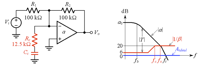

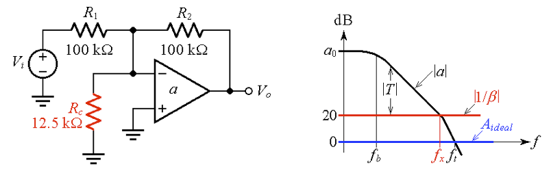

We can alleviate the limitations of resistive compensation by placing a suitable capacitance Cc in series with Rc, as depicted in Figure 7(a) for the inverting amplifier.
(a)                                                                                                            (b)
Figure 7.  (a) Input-lag compensation of the unity gain inverting amplifier, and (b) Bode-plot visualization.
Note that to ensure the desired phase margin, we need to trick the amplifier into the desired rate-of-closure (ROC) only in the vicinity of the crossover frequency ƒx, not necessarily all the way down to DC.
Physically, the 1/β curve breaks at the frequency ƒc at which the capacitive impedance’s magnitude equals Rc, or |1/(j2πCc| = Rc, giving
$$C_{c}=\frac{1}{2πR_{c}f_{c}}$$
Equation 5
To prevent appreciable erosion of the phase margin ɸm, it is customary to place ƒc about a decade below ƒx, or
$$f_{c}≈\frac{f_{x}}{10}$$
Equation 6

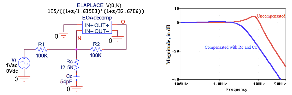

For the circuit of Figure 7(a), this implies Cc ≈ 54 pF. The simulation of Figure 8 yields measured values of ƒx = 2.38 MHz and ɸm = 61°.
Figure 8. (a) PSpice circuit to (b) visualize the stabilizing effect of input-lag compensation for the unity-gain inverting amplifier.

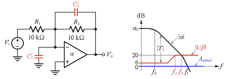

Input-lag compensation is notorious for creating a pole-zero doublet in the closed-loop response, which leads, among others, to intolerably long settling time characteristics. These shortcomings are avoided by the alternative compensation approach advanced by Michael Steffes and shown in Figure 9.
(a)                                                                                                (b)
Figure 9.  (a) Michael Steffes’ compensation technique for decompensated op-amps, and (b) Bode plot visualization.
We have already encountered a circuit of this type in a previous article on stray input capacitance compensation, so many of the considerations made there apply also to the present circuit, the only difference being that now C1 is intentional.
We are interested in developing two conditions for specifying the values of C1 and C2. At high frequencies, where the impedances of C1 and C2 are much smaller, in magnitude, than R1 and R2, we can ignore R1 and R2 and state that at high frequencies we have 1/β → 1 + C1/C2.
Imposing 1 + C1/C2 = 20 dB = 10 gives the first condition for our circuit example
$$C_{1}=9C_{2}$$
Equation 7
The second condition stems from the fact that
$$C_{2}=\frac{1}{2πR_{2}f_{c}}$$
Equation 8
so the value of C2 depends on where we decide to position ƒc.

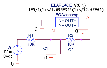

We start out with Equations (6) and (8), and use the PSpice circuit of Figure 10 to observe the AC responses as we gradually increase ƒc by decreasing C2 while maintaining the condition of Equation (7).
Figure 10.  PSpice circuit to plot the AC response of the inverting amplifier of Figure 9a. To plot the transient response, change the AC input source to a pulse source.

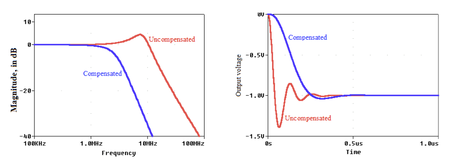

We stop when the AC response just starts to exhibit peaking. This approach gives C2 = 12 pF and C1 = 9C2 = 108 pF, resulting in the well-behaved responses of Figure 11. The AC response has a –3-dB frequency of 2.36 MHz.
(a)                                                                                                                               (b)
Figure 11.  (a) AC response and (b) step response of the inverting amplifier of Figure 10.
It is worth pointing out that any stray capacitance Cn present at the inverting input can be incorporated into this compensation scheme by changing the value of C1 to 9C2 – Cn. So, if, say, Cn = 20 pF, then we use C1 = 88 pF.
