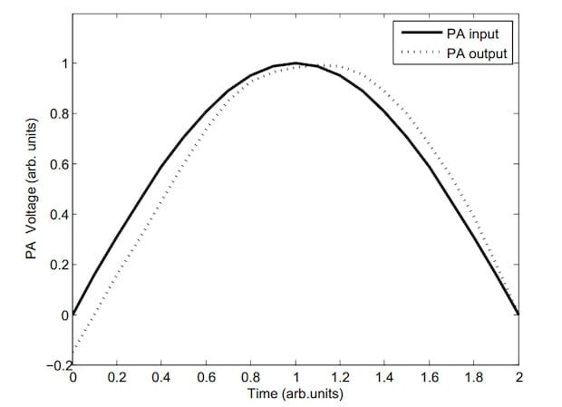

For predistortion to work, we need an accurate characterization of the PA’s nonlinear behavior. If the PA’s output is solely a function of its present input, this is relatively simple. In practice, however, the output of a PA is a function of both present and past input values. This phenomenon, known as the memory effect, is illustrated in Figure 1.
Due to the memory effect, the output is a function of both present and past input values.
Figure 1. Due to the memory effect, the output is a function of both present and past input values. Image used courtesy of John Wood

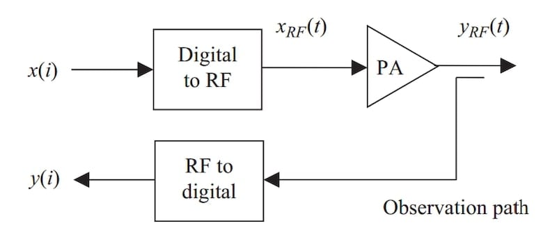

To observe the memory effect, we commonly use the more complex test setup in Figure 4.
The PA’s output is demodulated and digitized for a direct comparison with the original input signal.
Figure 4. The PA’s output is demodulated and digitized for a direct comparison with the original input signal. Image used courtesy of Richard N. Braithwaite
In the above diagram, x(i) and y(i) denote the digital input and output signals. The observation path used to produce y(i) consists of a coupler to sample the PA’s output and a receiver to convert the RF signal to its corresponding digitized value.
Once we know the values of x(i) and y(i), we can apply techniques such as mean squared error (MSE) to estimate the PA’s nominal gain. Deviations from the nominal gain are caused by the PA’s nonlinearity. Figure 5 shows we can study the PA’s saturation behavior by plotting the output magnitude as a function of the input magnitude.

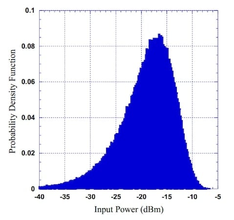

As this example demonstrates, real-world PAs may show considerable dispersion in gain magnitude and phase. The dispersion plotted above is more pronounced at lower input power levels. In order to ensure that the observed output dispersion isn’t caused by the input signal power distribution, we also need to check the input’s probability density function (PDF). The PDF of the input test signal for the above experiment is shown in Figure 7.
Probability density function of the LTE test signal.
Figure 7. Probability density function of the LTE test signal. Image used courtesy of A. E. Abdelrahman
The test signal's PDF shows lower values at reduced power levels, such as –30 dBm, compared to –15 dBm. However, the AM/AM and AM/PM characteristics display greater dispersion at an input level of –30 dBm than at –15 dBm. This confirms that the dispersion stems from the PA's memory effect, not the input power distribution.

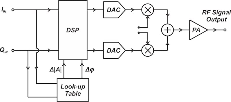

A predistortion circuit needs to exhibit the inverse transfer characteristic of the PA. The combined response of the predistorter/PA then becomes linear. If the PA’s behavior is quasi-static, identifying the appropriate predistortion function is more straightforward. In this case, we can assume that the PA’s output amplitude has a fixed, monotonic relationship to the input signal.
In the absence of the memory effect, the output signal's value is solely determined by the present input value. Consequently, it's possible to record the PA's nonlinear behavior and encode this data into a look-up table, which can then be utilized to implement a digital predistortion system like the one in Figure 8.
An open-loop, LUT-based predistortion system.
Figure 8. An open-loop, LUT-based predistortion system. Image used courtesy of Steve Arar
If the memory effect is present, however, we need to model the PA's memory effects. Techniques for doing so include the Volterra series, Wiener models, and memory polynomial models. We then incorporate these models in our predistortion linearizer.
