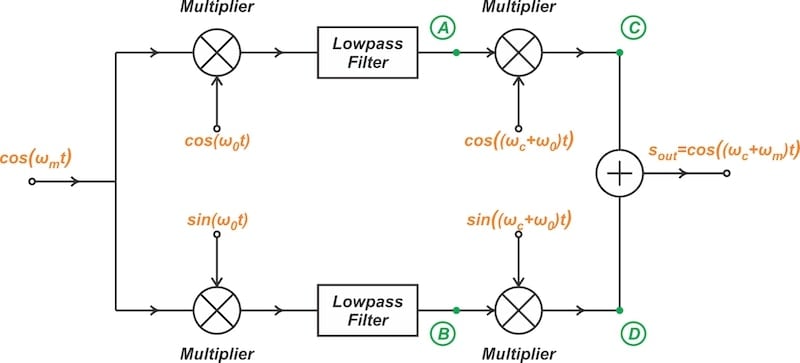

Let’s use Figure 3 to analyze the circuit’s response to a single-frequency message, m(t) = cos(ωmt).

Using a basic trigonometric identity, we obtain the output of the upper multiplier:
$$\cos( \omega_m t) \cos( \omega_0 t) ~=~ \frac{1}{2} \big [ \cos \big ( ( \omega_m ~+~ \omega_0)t \big ) ~+~ \cos \big ( ( \omega_m ~-~ \omega_0)t \big ) \big ]$$
Equation 3.
The first term inside the square brackets is at a higher frequency and can be eliminated by a lowpass filter. At the output of the upper lowpass filter (node A), we therefore have:
$$v_A ~=~ Lowpass \big [ \cos( \omega_m t) \cos( \omega_0 t) \big ] ~=~ \frac{1}{2} \cos \big ( ( \omega_m ~-~ \omega_0)t \big )$$
Equation 4.
The lower path in the circuit diagram multiplies the input by a sine wave. The output of this multiplier is:
$$\cos( \omega_m t) \sin( \omega_0 t) ~=~ \frac{1}{2} \big [ \sin \big ( ( \omega_m ~+~ \omega_0)t \big ) ~-~ \sin \big ( ( \omega_m ~-~ \omega_0)t \big ) \big ]$$
Equation 5.
The high-frequency component is eliminated as the signal passes through the lowpass filter, producing the following signal at node B:
$$v_B ~=~ Lowpass \big [ \cos( \omega_m t) \sin( \omega_0 t) \big ] ~=~ -\frac{1}{2} \sin \big ( ( \omega_m ~-~ \omega_0)t \big )$$
Equation 6.
Equations 4 and 6 indicate that the output signals from the lowpass filters exhibit a phase difference of 90 degrees. As you may recall, creating this phase difference was the key challenge of the phasing method.
We’re now ready to find the output signal of the modulator. Using vA and vB, the output signal from the Weaver modulator is:
$$s_{out} ~=~ \underset{v_A}{\underbrace{\frac{1}{2} \cos \big ( ( \omega_m ~-~ \omega_0)t \big )}} ~\times~ \cos \big ( ( \omega_c ~+~ \omega_0)t \big ) \underset{v_B}{\underbrace{~-~\frac{1}{2} \sin \big ( ( \omega_m ~-~ \omega_0)t \big )}} ~\times~ \sin \big ( ( \omega_c ~+~ \omega_0)t \big )$$
Equation 7.
We can simplify this expression by recognizing its similarities to the following trigonometric identity:
$$\cos (A~+~B) ~=~ \cos(A) \cos(B) ~-~ \sin(A) \sin(B)$$
Equation 8.
Applying this identity, the output signal simplifies to:
$$\begin{eqnarray}s_{out} &~=~& \frac{1}{2} \cos \big ( ( \omega_m ~-~ \omega_0)t ~+~ ( \omega_c ~+~ \omega_0)t \big ) \\&~=~& \frac{1}{2} \cos \big ( ( \omega_m ~+~ \omega_c)t \big )\end{eqnarray}$$
Equation 9.
The spectrum of this signal consists of two impulses at ±(fc + fm). These correspond to the upper-sideband components in Figure 4.
