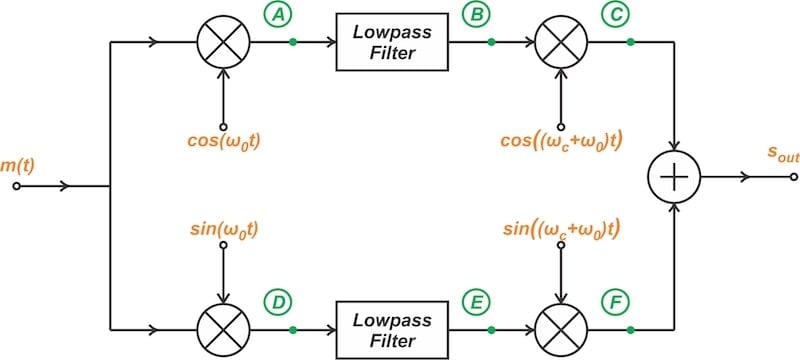

The previous article explained the basic principles of Weaver’s method using a single-frequency message signal. As we learned, the Weaver modulator requires neither the sharp bandpass filters used in the filter method nor the precise phase-shifters of the phasing method, making it the most practical of the three options listed above. Figure 1 shows the circuit diagram for the Weaver modulator.
Circuit diagram for the Weaver modulator.
Figure 1. Weaver’s method for generating SSB signals.
In this article, we’ll continue our exploration of this circuit by examining how an arbitrary input spectrum changes as it passes through each of the six nodes—A through F—identified in the figure above. Nodes A through C represent the upper signal path; nodes D through C are located along the lower signal path. We’ll then examine the output spectrum created by combining the upper and lower path spectra.

In Weaver’s method, the first pair of multipliers mixes the message signal with an oscillator whose frequency (f0) is in the center of the message signal’s frequency range. Since the message signal occupies a bandwidth of B, we have f0 = B/2. The first multiplier therefore creates two signals: one with the spectrum shifted up in frequency by f0, the other with the spectrum shifted down in frequency by the same amount. In both cases, the signal amplitude is halved.

The signal at the output of the lowpass filter is then fed into the second multiplier, where it’s mixed with a cosine wave of frequency fc + f0 = fc + B/2.

In most ways, the functioning of the lower path is like that of the upper path. The difference is that it mixes the input with a sine wave, introducing a 90-degree phase shift. Using Euler’s formula, the sine function can be written as:

Finally, the second multiplier of the lower path translates the spectrum by ±(fc + f0) = ±(fc + B/2). Due to multiplication by a sine function, the amplitudes of the upshifted and downshifted components are scaled by an additional factor of –0.5j and +0.5j, respectively.

We obtain the output spectrum by combining the spectra of nodes C and F, which represent the respective outputs of the upper and lower paths. These spectra can be found in Figures 5(d) and 9(d). However, to help us more easily visualize this, Figure 10 also reproduces both spectra along with the final output spectrum.

As we can see, the upper sidebands emerge at the output. The lower sidebands are removed.
