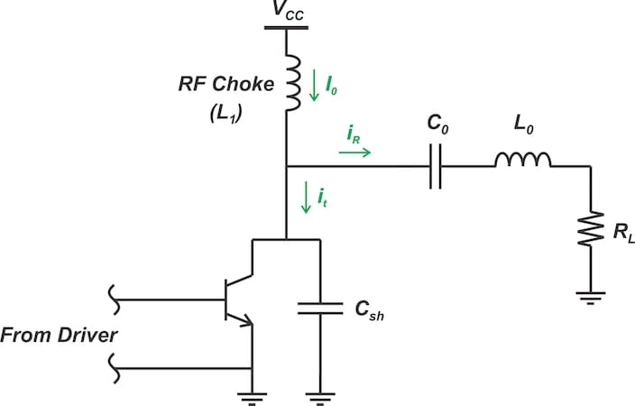

Figure 1 shows the basic Class E stage we’ll be examining. Its typical switch waveforms are shown in Figure 2.
Schematic of the basic Class E Amplifier.
Figure 1. Schematic of a basic Class E amplifier.

The RF choke provides a DC path to the supply and approximates an open circuit at RF. In Figure 3, the DC current through the RF choke is denoted by I0.
The RF choke supplies a DC current of I0 and the sinusoidal current iR flows through the load.
Figure 3. The RF choke supplies a DC current of I0 and the sinusoidal current iR flows through the load.
